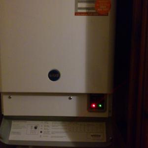

    pic shows the lights - when i press the reset button the red light goes out and the boiler tries to start - every 10 seconds or so i hear a click as if it is trying to ignite but nothing happens until the red light comes back on and back to square 1! thanks again. (i can live without cooker hob...

    power light on. red lockout light on - pressed rest button and the boiler tries to start (red light goes out for short while)- exhaust blowing cold - no green (burner on) light. thanks.
