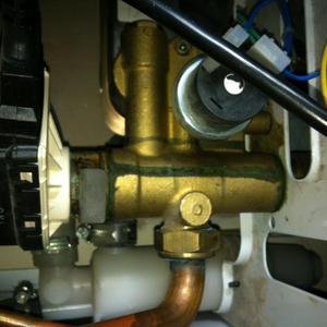

    Baxi combi 28HE hot water issues
    Thank you very much, that is what we thought. This will sort the leak, however, he indicated that what is causing the lack of hot water is stuff clogging up inside this valve, which he intends to resolve by draining the boiler and using some sort of corrosive to get rid of this stuff. How...
    Thanks. Here is a picture of the diverter valve, the dark lines are where the leak has discoloured the metal. Sorry, not sure how to rotate the image!
    Hi all, First time posting here, hope someone can help. I have had a look and found similar issues but not quite the same in the forums. For a couple of weeks we have had intermittent hot water coming through, sometimes it will be completely fine, other times it isn't coming out hot but...
