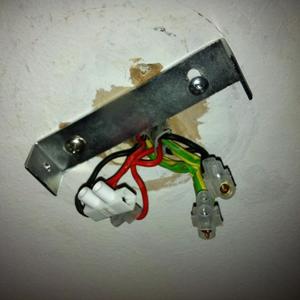

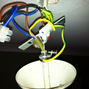

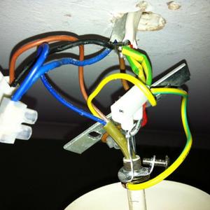

    Thanks guys - light switch had blown!!

    Hi all, I’m trying to replace a ceiling light with a basic ceiling rose. I can’t seem to get it to work. Picture one I have red live coming out of the ceiling into brown live on the rose Black neutral from ceiling going into blue neutral on rose Then that unsheathed wire which I presume...

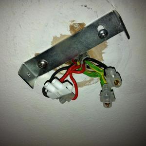

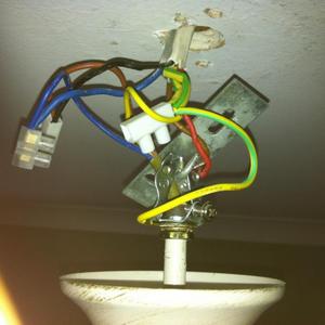

    Unbelievable, it was the dimmer switch that had blown! From when I incorrectly wired the lights yesterday. Swapped it over and it's all working. Thanks very much for all your help, I'll make a donation to the forum charity. Cheaper than a sparky anyhow ha ha. cheers again everyone.

    I've uploaded some more images. The three called dining before are the dining one's, before I even took away that old light. The TV now ones, is obviously the TV one, but with no light on. Dining room before Tv now

    Ok cheers. If it is those three red loops or the two blacks, any idea on what to change with them.....or should I admit defeat and get an electrician in? cheers again

    Hi Chaps, Wonder if you can help, spent all weekend at this and have had a real good go and done research online so I did try, but have hit a brick wall and need to ask, hope that's ok. Basically I have one double light switch (a dimmer which I fitted). Off that, I have two ceiling lights...
