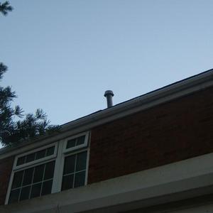

OK, Sorry to sound thick but can someone enlighten me.
Is this installation correct.?
Internal vertical soil pipe with one connection off it feeding the bathroom.
As the pipe enters into the loft a AAV has been fitted ,on top of that the exhaust from the shower has been connected which in...

At the time he did the flashing I asked about the fitting,why would he fit one of those?. As I understand it they are some sort of air admittance valve.?

We've recently moved house and had a new bathroom fitted.
New house has an internal soil pipe running down thru the bathroom and kitchen.Whilst the bathroom was being installed I noticed the flashing on the roof had failed and got the plumber to...
