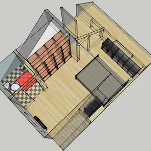

    Loft door (not hatch) sizes to meet BR
    We are partway through a loft conversion and I am about to begin boxing in the stairwell where it meets the loft floor. I am aware there has to be a minimum 400mm landing area off the stairs but can't seem to find any regulatory information concerning door height/width and relevant casing...
