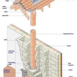

    I have found a very helpful pdf from Wavin UK who make chimney components if anyone else is ever interested the link is https://environment7.uwe.ac.uk/resources/constructionsample/Conweb/heating/hepworth%20chimneys.pdf Taken from that pdf here is what I currently have fitted in my home...

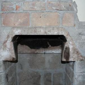

    The flue is a proper class 1 and if you lie on the left hand side of the fire you can see all the way through. It has passed smoke test last few years so I'm not going to use a liner as it will save a few quid. The fire states it must be converted to rear vented by sealing off the flue liner...

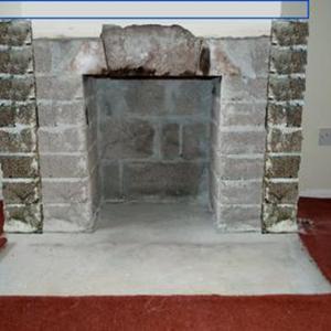

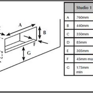

    Im trying to install a new 'Hole in the wall' type fireplace into my old chimney. The new fire requires an opening in my chimney like this (Studio 1 dimensions in left column) The current chimney is quite narrow 1025mm wide, the opening is currently 560mm wide by 590mm high. Having...
