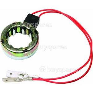

    hotpoint aquarius washer dryer won't spin properly WDL520
    well found wire snapped inside plastic right at the tacho end, managed to scape away some of the block and solder a new wire in place and now properly spins up again begs the question of who wrote the software that allows it to run without a tacho when no temp sensors connected... will do...
    ok just realised that the lights up the side are a binary code of the error code and discovered that the error is F02 which means motor/tacho issue which fits with what is going on i tried to measure the resistance of the 2 wires coming from the acho and seems to be open is it...
