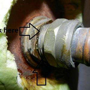

    I have a screwfix 27in incaloy heater in my hand, I can confirm the thermostat tube is made of the same grey metal as the element, definitely not copper or silver paint :-) I notice the one Wickes is selling has a copper stat tube though, in the photo at least... I wasn't offered £10 or...

    Tony do you mean I shouldn't use the Screwfix Incoloy immersion heaters such as this? It says suitable for stainless steel cylinders. http://www.screwfix.com/p/27in-incoloy-immersion-heater/57798

    Many thanks for the help Tony. Should I go for copper or steel for replacement tank? Reviewers on Screwfix site seem to like their steel tanks because they have easy 22mm connections? Phil

    Hi, my indirect vented hot water cylinder has just started leaking slowly (4 drops per minute) from the upper coil connection. I think I bashed the pipe and started it :-( The water is coming out between the threaded pipe and the nut on the tank, as shown by arrows in photo: What is...
