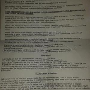

    No wiring diagrams only these 2 pages and the invoice , its the same as the old Transformer that was in so I put the wires in the same contacts

    Uploaded instructions for the Transformer
