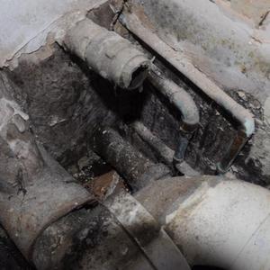

    Help with this waste pipe mess please...
    Ok so I have managed to get into the cupboard the other side of the wall. It appears that there is a main soil pipe coming straight down from above and a separate thinner pipe next to it. Seems like this is what the uncapped pipe is connected to. Would this be a vent pipe? if so why is the pipe...
  2. P
    Yes you are right it is awful!! The one entering the wall at the far corner at the bottom is the sink waste. I don't know who installed this, but it seems to be a bodge job. the uncapped pipe leaks ever so slightly when the kitchen tap is running and also when upstairs flushes the toilet (its...
  3. P
    Ok so I am a long time visitor, first time poster. Recently I noticed in the bathroom that the skirting board near the toilet had become damp. I lifted up the vinyl flooring to find it soaking wet with what looked like waste water. Now I am no plumber but thought I would have a crack at...
