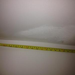

    Thanks Dan. I probably didn't make clear that the pictures of the internal damp damage (where the walls are white) are taken prior to the the damp proofing repair, the current problem is in my third post on the thread (yellow walls). 1. The skirtings were knackered and being pushed off the...

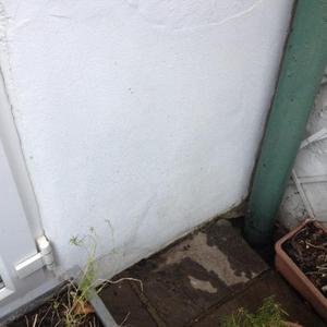

    Thanks for all the replies so far. I've done some more research and digging and I suspect that at least some of the problem stems from the patio the previous owners laid outside. I'd be grateful for your thoughts on whether I'm on the right track here. Unfortunately the site won't let me upload...

    Ok so I can assume the DPC man isn't going to be returning my calls anytime soon, which is what I'd expected. Any suggestions on how to tackle the root cause of the damp and at least tidy up the interior? There are some photos of the exterior and interior here: Obviously the...

    Hi everyone, I originally posted this in the plastering section but it seems like this is probably more of a building question. I previously had a problem with rising damp on the inside an external wall in my kitchen. The outside of the wall has a step against it and is rendered down to ground...

    Hi all. I was hoping some of the experts here might be able to help me out with a damp problem... Situation: early 1900s house, solid brick walls with no cavity. The outside wall has a wide step up to the patio doors approx 10cm high, and is rendered down to ground level with a cement mix...
