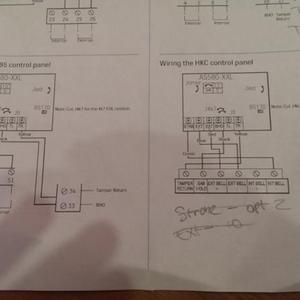

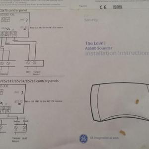

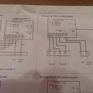

    Issue wiring Bell Box to Scantronic 9651 Panel
    Hi, Sorry for the delay in getting back to you all... Thanks to all for all your help. I have uploaded pics of the bell box itself and found some documentation that came with the bell box... I am suspecting the 4k7 EOL resistor is the culprit... but that is just a guess... images...

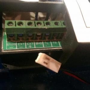

    thanks for your reply... what are the ext - and ext+ connections ? Thanks, Richard
    Hiya, Bit confused on the wiring here... Bell Box has the following terminals... Strb - Ext - Ext + Bho TL TR 9651 Panel has... OP1 OP2 OP3 TR SPKR - SPKR+ Any idea's how to wire it up ? Thanks, Richard
