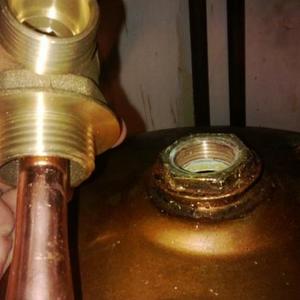

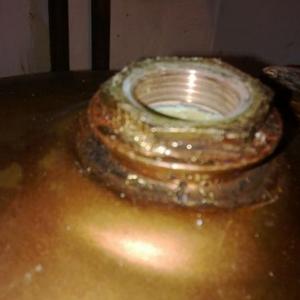

    Fitting on top of hotwater cylinder stuck
    Thanks for comments. Before I ordered a new flange I had one last go, being liberal with the blowtorch and the spanner and the fitting came off, so gas and agile, you were right! thanks

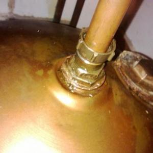

  6. R
    Thanks for your reply Sooey. Well as you can see in the pics, the heat removed the top fitting, but I'm right in thinking that the other lower one shown comes out as well? because otherwise the flange ain't fitting... Just how liberal is it acceptable to be with the blowtorch? I'm a bit...
  7. R
    Hi, I'm trying to remove the fitting from the top of my hot water cylinder to fit a surrey flange to feed a new shower pump, but it is thoroughly stuck! I've put plenty of WD40 on it and left it to soak in for hours as well as removing all of the gunk/rust that was around the fitting, but...
