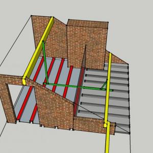

    Support for Purlins
    I've had a builder around to have a look at this. The red floor joists have been notched to accomodate a waste pipe. This has been done right in the centre of the span on the top surface. The angle iron is acting as a binder as Woody explained.
  5. R
    Support for Purlins
    I am in the process of extending the floor area of a room in my house into the loft space. Below is a drawing of the current state of the room. The key to the colours is as follows: Yellow...Purlins Red... Floor Joists Green...2" Angle Iron The Angle iron will need removing at some...
