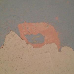

    What's this on my wall?
    Thankyou! We are now proud owners of a bucket of Gardz. Horrible man-flu incapacitated me for most of the weekend, but I will report back on how we got on once we get started!
  2. R
    Sounds not too bad after all.. soo, would the plan (and the right succession) be: 1. Sand down any proud bits (there's a few repairs in places that have a bit of a bulge) 2. Wipe everything with damp sponge, wait for it to dry. 3. Coat with Zinsser Gardz 4. Repair holes and cracks...
  3. R
    Ugh.. I had a feeling that it's no good sign that the stuff started becoming smeary when wet. I'm new and clueless when it comes to these things, so apologies if I'm asking very obvious things: - You mention Zinsser Gardz to seal in and stabilise the wall. Do you mean applying it to the...
  4. R
    Hi all, First time poster and proud new owner of 'a bit of a project'. I have the feeling I might frequent these forums quite regularly from here on... We are currently doing up the first of three bedrooms in our 1960s house. We had someone in to plaster over the Artex ceilings and they...
