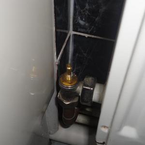

    Best tool for lockshield valve
    It was a stuck TVR. Thnaks Everyone
    Hello I have a radiator which is not functioning, in the bathroom. It is cold while all other radiators in the house are hot. I have bleed the radiator to force out any airlocks but this did not make any difference. I’m trying to loosen the lockshield valve but I don’t have a tool to do...
