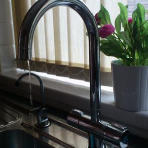

    dripping swan neck mixer taps
    Bought two of the ceramic cartridges and have successfully fitted them :P Thank you so much for all the advice. Feeling REALLY pleased with myself.As a single mum of four I've probably saved quite a bit of money. Will definitely be on here again .
    The sink and taps are both Franke and were quite expensive, have taken the hot water side one off will take to the plumbing suppliers and buy .. Wish me luck .. I may need it !! Thanks AGAIN
    Hi, Hope the picture has come through okay, Thanks Ros
    Hi, Thanks for getting back to me, No it's not leaking from the base of the swan neck , it's dripping from the spout. I bought the 0 rings from a local repair shop, took the original with me to make sure I got the right size. The ones that I took off seemed worn and flat compared to the new...
    Can anyone please help me ? I have removed the neck of the mixer tap and replaced the two o rings but the tap is still dripping .. HELP it's driving me crazy !
