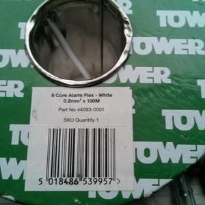

    Alarm cable suitability for AG6 Siren/Bell Box
    Arr yes cheers EightyTwo and desig and thanks the pdf for the AG6 it states: "LOAD CURRENT 35mA nom. Quiescent. 260mA nom. Combined sounder and strobe. 125 mA nom. Strobe only." So all's fine I'm surprised how little these things draw! I'll quad-up all 8 cores with it for the mag...
    Well I needed some cable in a hurry so bought it from sf rather than a proper alarm shop/supplier and thought it looked a bit thin. Like sf had gone for the cheap and cheerful - as they only stock the one type. It's 8 x 0.2mm but I guess double up the power which then provides 0.4mm so I...
    Hi Guys just after some advice I have wired my new alarm system in the cable below but worried it may not be heavy enough to power the Honeywell AG6 siren? http://m.screwfix.com/p/alarm-cable-6-core-100m-white/26551 Pic here http://www.diynot.com/network/scottharry/albums/ Cheers...
