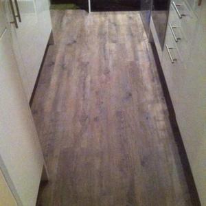

    Advice needed- self leveling compound over existing compound
    Thanks dazlight :) Well, I spent the whole of this evening after work putting down the vinyl planking. (Last night I put down the gerflor primer on top of the screed which had been down for about 30 hours prior). Managed to finish everything. Just need to put the dishwasher back in place...
    Progress... Just put down the screed after having primed beneath. I went up to the edges of the plinth's after first masking the bottom of the plinth along all edges, and filling the gap between plinth and floor with silicone - so that none of the plinth soaked in any moisture from the new...
    Hi all, Re-doing our kitchen floor and its the first time I am tackling this type. The old flooring was vinyl sheet, and I am going to lay vinyl plank down in its place. After removing the vinyl sheet, I found that self leveling compound was previously used. Another issue is that kitchen...
