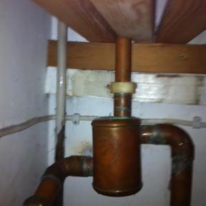

    can someone help to identify this?
    Does it mean I need it? Can I cut it out and just leave with a junction? I am not a plumber and would not be able to solder the pipes. However, I would be able to use compression elbows and junction.
    There are two pipes that join up 30cm further up. One of them I believe is from the tank. The problem is that I think its clogged and there is no flow through the system. The magnet sticks to it.
    [/url] Thanks Do I need it and is there any alternative to put instead as it seems to be the cause of the problem on my system?
    Hi there, can someone please tell what is this, its name and purpose? It seems that is clogged up, if I bring magnet to it - it sticks! Thanks
