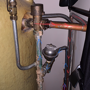

    Replacing a hot water tank - is this reasonable?
    Just checking out the bath mixer now. No isolation valves (of course!) but the HW feed that comes into the bath tap is directly tee'd off just before that for the shower feed. Showers keep HW coming through, bath does not. I'm wondering if the mixer is somehow drawing cold in?

    Screenshot 2021-02-18 At 10.44.59 by shorn posted 18 Feb 2021 at 10:55 AM Just had a look at the blending valve, and starting to understand it a bit better. So I've marked where the cold feed comes in. This comes up and mixes with the hot water that's coming out at the valve. Just tested and...
