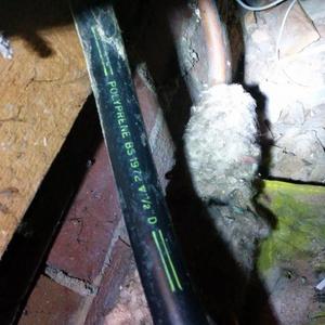

    Imperial mains to metric copper connection
    Would one of these work? http://www.jtmplumbing.co.uk/pipe-fittings-c433/compression-fittings-8mm-28mm-c42/compression-straight-tap-connector-pp965 http://www.jtmplumbing.co.uk/john-guest-speedfit-c432/john-guest-speedfit-fittings-c167/john-guest-speedfit-straight-tap-connector-pp3240
  2. S
    My understanding is the ID for class D is 14.1mm. Would a 15mm pipe insert fit?
  3. S
    Hi, My stoptap is leaking and needs to be replaced (I've tried repacking the gland nut, no luck). The current setup is show below. The mains pipe is Polyprene BS 1972 Class D with a 21.5mm OD, and according to http://www.stevensonplumbing.co.uk/alkathene-accessories.html, a 14.1mm ID. The...
