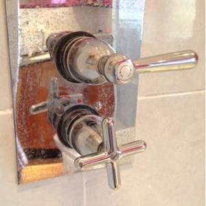

    Anyone recognise this shower tap?
    Thanks for the advice. I went to Showerdoc & was pointed in the right direction (it's a Crosswater). Rather than replacing the cartridge, I took it apart as suggested & gave it all a good scrub & Oust'd the cartridge. All appears to be ok with the hot water at present so will see how it...
  2. S
    Hi All, We're having problems with cold water passing back into the hot water pipes & appear to have narrowed the source down to the shower. The issue is that we can't identify the make/model of the thermostatic valve so that we can replace the cartridge. Does anyone have an idea of the...
