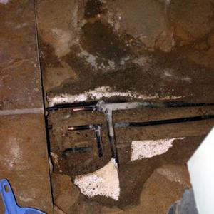

    Just thought I'd bring things up to date. To find the leak, the plumber had to dig up the floor: With the water back on, a steady trickle of water was seen following the path of the pipe that was feeding the kitchen sink. Although we didn't actually dig along to find the actual...

    I'll try to make this as brief as I can, it may be of interest to some. I've added a few pix as they speak loader than words of course. March/April we noticed damp on internal wall: There was also evidence of water running on external render, low down under the DPC. This picture...
