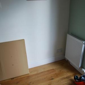

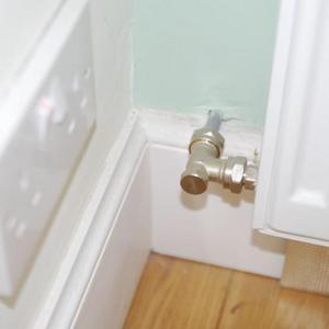

    Thanks Tony - My kitchen really isn't that big 12m2 just the Smiths website give room size in cubic meters. I do have another radiator in the room but doesn't kick out a lot of heat (just looks nice!). It is micro bore so will I be able to get a 10mm to 15mm connector do you think? Think I...

    Second post - be gentle! I am adding a hydronic plinth heater and my kitchen it is 27m3. The room has 3 external walls and hardly any insulation (very old farm house). Is there any harm in adding the smiths SS9 it is for 49m3. I was about to buy th SS7 which is 36m3 which looks like enough...

    Sorry to hijack this thread but I am struggling a bit to get my head around installation of a hydronic heater - pictures below. I am added units and am looking into a hydronic heater to replace the radiator. Can I plug the heater directly into the socket that is already there. Also is there an...
