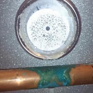

    Thermal Store Leak...
    Thanks. It is hard water, but I do have a magnetic scale reducer fitted on the mains water feed - I would have thought that would do it? Isn't the water in the store itself pretty much standing water anyway? If thats the case then scale shouldn't be a massive problem, I wouldn't have...

    Hi - I have a thermal store, about 6 months old, which was supplied by Newark with two temperature gauges pre-installed. This week I dug all the towels out of the airing cupboard to check what was going on back there, and I found one of the gauges seems to have sprung a small leak... See...
