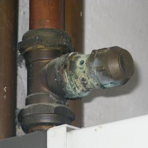

  7. S
    What is this valve?
    Thanks! I'll leave it where it is.
  8. S
    What is this valve?
    Thanks Spraggo! The positioning of the valve didn't seem quite right for an air release valve :? Do you think there's a chance it could be restricting the flow from/to the boiler - ie would it be a good idea to discard it, or is it best to leave well alone!?
  9. S
    What is this valve?
    There is some kind of valve within the branch of the tee. There are holes all round the circumference of the branch between the pipework and the cap. Ever since the fitting stopped leaking/working, we've had trouble with air in the boiler.
  10. S
    What is this valve?
    First post time :D I wonder if anyone could help me to identify this valve: It is fitted to 28mm pipework just above an old Potterton Netaheat boiler. It used to leak (hence the limescale!) but hasn't done so for a while. I assume it's some kind of air release valve, but can't...
