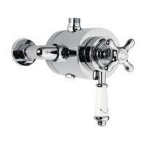

    Mixer Shower Inlet Filter
    Hope thats what you mean, I have taken the picture off bathstore website. Thats where I bought the shower from a couple of years ago. I stripped it down by removing the temp control then on/off control. That brings me to the valve body with the splines of the controls sticking out of the...
    Cheers, I've just tried it with the valve out but unfortunately cold water is then drawn through the mixer into the hot feed to the bathroom taps so I've had to put it back in. I've stripped the mixer down and can't work out what the cartridge is. I'll keep trying different things I suppose...
    I've got a mixer shower running of a combi boiler. For 18 months is has been great. Recently it has failed to get very hot. I took it off the wall and found that the non-return valve was stuck in the hot water inlet elbow. I freed it off and have put the shower back together. The temperature...

    Thermostatic Shower Valve Inlet Problem?
    I fitted a new shower a couple of years ago. It's a thermostatic mixer valve fed from a combi-boiler. It has operated great, until recently the temperature from the shower has fallen. I've stripped it down and eventually traced the fault to the elbow where the hot water enters the valve. It...
