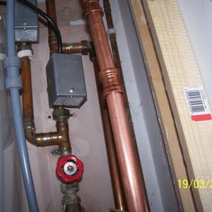

    Automatic Bypass Valve continually rattling.
    But should it be in operation (rattling) the whole time or only if it comes into play work? My one is rattling the whole time the CH is turned on. This would appear to be allowing flow through the bypass all the time rather than when the zone valve or TRVs were switched off. It is not a major...

    Yes the valve is fitted the correct way - arrow in direction of flow. It is a Honeywell DU145. No it doesn't scream. There is a rattle coming from valve continuously when th CH is on. I am presuming that shouldn't be the case. The valve is set tp Number 2. It is difficult to get at - need...

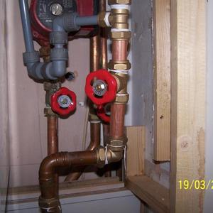

    http://www.diynot.com/network/SquiddlyDiddly/albums/10193 I don't know if you can see these now. As I have already brought the vent down and the feed is on its way, I am planning to tap the feed into the vent - with a U turn as you suggest. Thanks for reminding me about the bleed valve...

    Following the advice of mysteryman, I embarked on the project to move the vent and feed to the return side of the boiler before the pump. I only had time to do the vent as I had run out of coppeer pipe - on a Sunday. To my horror when I restarted everything the vent still flowed with...
