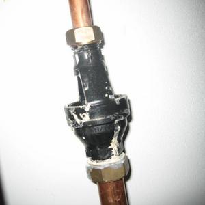

    Tundish question
    Hi, I've been up in the loft and taken a few pictures to show the installation. As you can see, it's fitted the correct way up, the outlet is 22mm and the inlet 15mm (I haven't measured them but that's certainy the impression I get!). The second one, the close up of the tundish shows the...

    Tundish question
    I've a Megaflo CH / hot water system and there is leak from the tundish whenever water intermittently drips through it. I realise that the internittent drips mean that the air gap needs recharging but my problem is that the tundish leaks this water! I can replicate the problem by manually...
