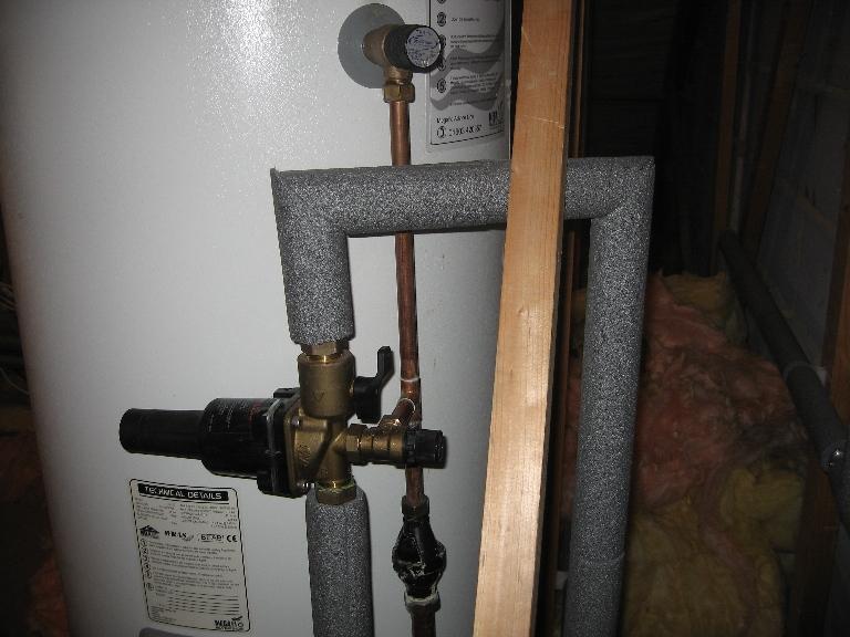

I've a Megaflo CH / hot water system and there is leak from the tundish whenever water intermittently drips through it. I realise that the internittent drips mean that the air gap needs recharging but my problem is that the tundish leaks this water!
I can replicate the problem by manually turning the relief valve on and off, water simply seems to splash out of the tundish and drip down the pipe onto the plasterboard below.

Hi,
I've been up in the loft and taken a few pictures to show the installation. As you can see, it's fitted the correct way up, the outlet is 22mm and the inlet 15mm (I haven't measured them but that's certainy the impression I get!).

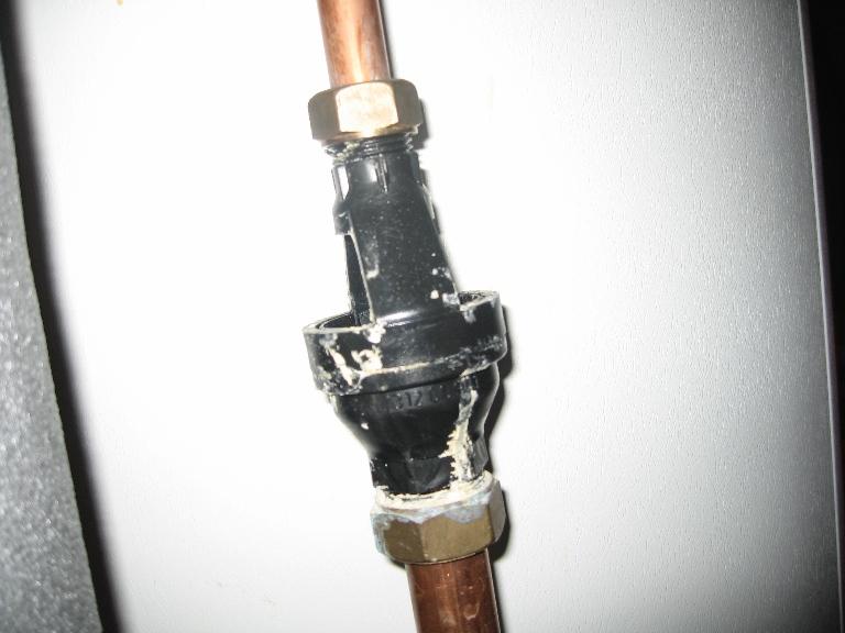

The second one, the close up of the tundish shows the extent of the leak as there is a limescale build up all over the tundish, and that's after a rough clean! Contrary to how it appears in the picture, it is installer perfectly vertically!

To be honest we find that style of tundish crap, when the prv/tprv operates we find that regardless of d2 pipe size they always spray from the points yours is showing.
those dishes can swivel around and tend to leak where yours is.
more often than not now we make our own.

You could have a piece of 15mm pipe pointing down, just above a 28 or 35mm joint pointing up.
Mate i have come across this problem quite alot,you can get a larger tundish to accomodate the water, its slightley a different style and a bit larger.
you can buy copper or brass ones, the style you have is normally similar to the altecnic range.
22- 28 reducer with 15 going in serves the same purpose in your case.
remember its purpose is to create an air break and for discharge to be visable.
To be honest its more important to stop the discharge than worrying about the tundish leaking.
