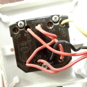

    D'oh! So; simply switch (sic), then pop the new fella in. I can see no earth connections on the (plastic) Tenby unit. I presumed I would simply connect an earth cable from the srew plate on the switch into the depth box connection. Not right?
  8. S
    3-gang comaprison/change

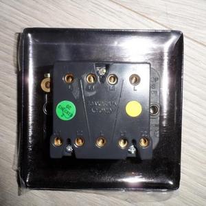

    Hi all, First post on here and, with apologies for asking what many may have already posted, I have bought a Volex black chrome fronted 3-gang switch to replace the existing Tenby unit. Naturally, the labelling and connections are entirely different in both switches, leaving me suitably lost...
  9. Volex 3-gang
    Volex 3-gang
    The intended replacement for the Tenby unit: a Volex black chrome switch.

    How the current Tenby switch is wired.
