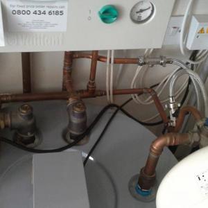

    This just came in from another source: "Those cylinders rust through on the coil. So the hot water is pressurising the boiler. It will need replacing. Get a Santon Premier Plus, or a Stelflow. All pipe work will need altering as the Vaillant cylinder is a short dumpy type. The heating will...

    Okay with no pressure in boiler circuit and tap side of the tank (i.e. taps run dry), open system isolation main valves, but kept filling loop valve closed and pressure builds on the boiler guage! It builds slowly to 3.5 bar! Taps run again and boiler circuit is full with safety valve working...

    This one is driving me mad. Water was dripping outside through the discharge pipe, so checked the boiler pressure guage and it was indicating 3.5 bar! (Well over the 3 bar maximum) Initially suspected the Pressure Reducing Valve. It was looking wet also. Pulled the cartridge out and it was in...
