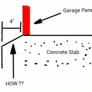

    How to Create Chamfer on Concrete Base for Garage??
    Cheers for the advice guys. Next question, how do i know when it's green? I'm thinking crumbly but not too hard, enough to hold its form but still obviously not set. Or is there a set time against temperature one can get a rough guess from? Cheers again.
  4. S
    Cheers John, Sounds like a good idea with the silicone sealant. I suppose if i do both the sealant AND chamfer then the water will run down the panel and away once it reaches the chamfer, reducing it's time to be able to seep through? I know that most of these sectional garages have...
  5. S
    Hey all, Long time lurker first time poster. Never had the need to post really as I've managed to find everything i need via search, until now lol. Basically I'm laying a concrete slab for my soon to be erected sectional concrete garage. I've read a lot about the dreaded water ingress...
