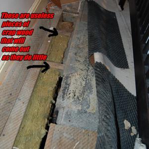

    What lies beneath...
    Woody, I have uploaded a pic of the offending area. The stone section you can see sits on a piece of wood that is nailed between the two 'floating joists'. I haven't taken up any more floorboards yet. What is a trimmer joist? Is it a joist that is attached at right angle to the floating joists...
    The noggin I mentioned only spans between the 2 cut short joists Are you saying that the other noggins along the rest of the length which I can't see are the ones which are supporting it sufficiently?
