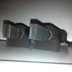

    The brushes are about 2 cm long with no error lights on the machine. I actually got the machine working last night by cleaning the cummutator and gently sanding the tips of the brushes... Fixing it all back together and checking all the connections as per your advise, the machine starting...

    Thanks for the quick responce, I have removed the brushes but as this is new territory for me do they look like they need replacing? Please see the image.. Many Thanks

  4. Hotpoint WF440P Brushes
    Hotpoint WF440P Brushes image, do they need replacing?
