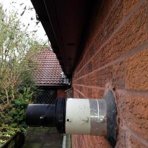

    Hi Hope you can help. Before I go any further I would like to state that I do not intend to carry out any repairs myself as I am a spark and will get an appropriately qualified installer to do it. I have a WB Greenstar 40CDI Conventional. I have recently noticed pools of water beneath the...
