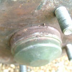

    nissan almera 2004 disc removal
    hi thanks everyone it looks one piece but its not .the hub bit sticking out is tapered fits tight around disc .anyway got it off with a rubbber mallet lots of knocks while rotating it hope the other side is easy lol thanks everyone
    hiya here are some pics
    They seem to be held on by hub haynes manual says they jus pull off mind u haynes not always wright
  10. S
    So its not held on by the hub nut the hub cap hub bit looks part of disc
  11. S
    hi trying to get disc off a nissan almera 2004 removed calliper plus bracket wheel the disc seems to move a bit around studs but is tight in the middle is there a hub nut holding it on under hub cap?
