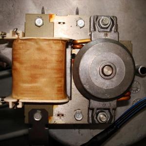

    thanks rocks for getting back to me so quickly! fan blade has been replaced and I have flushed water through the hole under the fan to remove any fluff (the condenser, i hope!) with the machine on, I cannot feel the spindle on the dryer motor turning (i have attached a photo and assume the...

    My indesit WIDL126S is not drying. The heating element is fine, I though at first it might be the thermal fuse but, having bypassed it, I get the same problem. The drum goes round but after a short while i get flashing lights 1,2,4 + door lock. I believe this is error code F13 - dryer...
