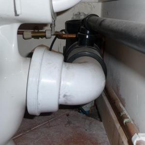

    Thanks for the suggestion. To replace the spigot tee is going to be a bit more complicated as can be seen from the second of the first two pictures as my original plumber was a bit creative in coping with all the services which come into the house in this corner. As long as it is not going...

    Hope this view helps.

    Difficult to do but if you give me a few hours I'll see what I can do. I'll post it on as soon as I can. Thanks again.

    I had thought about a joint on the elbow but was concerned about solids causing a problem as it was on the bend? If you think I'd be ok then that could be the route. Thanks.

    I wish to connect a shower tray waste to the soil on my loo but need to get as low as possible without having to get a ladder up to the shower tray! The waste in the picture is 32cm above the ground. Is there another fitting I could use maybe on the elbow? I am aware of pumped waste systems...
