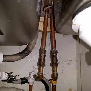

  6. T
    Replacing kitchen tap. Advice please.
    I have a Grohe Ambi tap which I want to install. What do I need to do. Do I need an adapter? I have added a photo in my pipes album. The current tap has copper piping that narrows near the worktop. The new tap has the bendy hot and cold pipes. So presumably I need to remove the top part of the...
