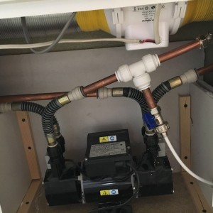

    Aaah, bit slow off the mark there. I'll have to run it from the kitchen tap instead as that should be from the mains whereas all the other taps are from the header tank?

    Thanks Jackrae. The pump only starts when the upstairs shower is turned on. If you just use the upstairs sink then it doesn't start and the pressure is relatively poor but still useable. There is a filter in the fridge and it is full of water so the water is getting to the fridge, there just...

    Thanks Bernardgreen. I think the T is before the pump though so I believe it is potable water, not after the pump. It's the cold water supply to the pump as far as I understand it. Edit: Will fix the wiring on the extractor

    Hi Moved into a new house and there is a pipe running from a connection below a guest bedroom sink (in ceiling above) to where the fridge goes. Having connected our fridge the water pressure appears to be too low for the water to reach the dispenser in the fridge and the ice machine (pressure...
