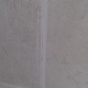

    The builder reckons he used 12mm waterproof ply. He is agreed to come and take a look at it. I think I'll wait for him. The shower is not used anyway.

    It is not loose at all. If I push it it moves a little but not in a loose kind of way. I wonder if the board behind is moving.

    I wasn't there when it was done. But I can say with 90% certainty that it was smeared over, the old grout wasn't raked out. The tile doesn't appear to be loose, but the tiles on either side have very small movements.

    This is fairly new shower in the loft conversion we did last year. It is not used often. I tried to use it once a week to keep the negative head pump going. I went behind the plywood and didn't see anything untoward. I don't think the ply is rotten or anything. What's my next move?
  11. T
    Hairline crack on the shower tile grout
    There is a tiny hairline crack in between two tiles on the grout on the side where the shower unit is installed. It is at the bottom of the shower near the shower tray. It was fixed once but it has come back. If I push the tile, it appears to be moving a little. There is plywood behind it...
