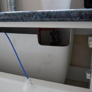

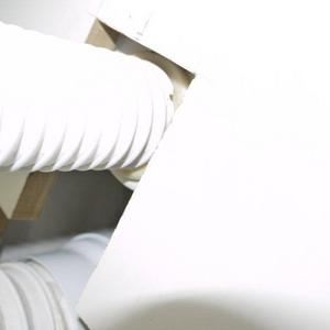

    cistern to toilet connection
    Hi, it forms a 90degree bend - vertical into cistern and horizontal into bowl. It doesn't appear to be sagging but it slides off very easily - doesn't appear to be contaminated, just a poor fit and too short I guess. Will look for the Wirquin (I think that's the make of the flush system...

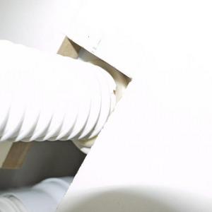

    Thanks for that, do they only come in one size or am I better to take the original off as a pattern & get the next size up? Also, how are they fitted in the cistern - any nuts or is it just push fittings? - can't get head in to see......
    A bit like the flexible one top left, but it doesn't look like a ready-made one, more like a cobbled together to fit type of thing...
    We had a new bathroom suite fitted a year or so ago and the cistern to toilet connection has started to leak. Needless to say, the plumber who installed it is now no longer around, but I need to know what the best way is to replace/repair the connection. The leak is at the toilet end of the...
