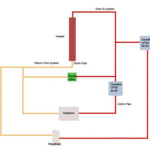

    Poor circulation on central heating (light commercial)
    The problem has been fixed. Found a special filter on the return pipe (not a y strainer but actually an inline filter) that was roughly 60% blocked with sediment. This was reducing the return pipe diameter by probably about half hence leading to poor circulation. We cleared it and circulation is...
  2. T
    Both sets of pumps are definitely working. On the radiator circuit return before the Tee connection there is something called a Tacometer which has a directional arrow but im not sure what it actually does. I actually closed off the flow and return to the megaflow circuit but it had no...
  3. T
    I hope someone here can shed some light on my problem. There appears to be some kind of circulation problem on the central heating side of the system but I am unsure of the cause. We have a low loss header fed by two keston C55 boilers. When the bypass valve is closed there is a pressure...
