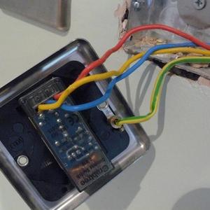

    Genius! This was the fix. Really appreciate your help (and everyone else that chipped in here). Chris

    If you look at my first comments in this thread, this explains exactly what happens with each switch. Also, I have just confirmed the following: Remove wire to L1: kitchen light does not work but bathroom light does work. Remove wire to L2: kitchen light does work but bathroom light...

    Yes, as I said, the downstairs bathroom is on the other side of the wall so it seems as though the lights for the kitchen and bathroom are linked somehow (see my earlier comments above for more details). I guess I may need to disconnect the cover for the light switch in the bathroom to see if...

    Here's a picture. No other work has been done other than change the dimmer.

    I currently have red going to C, blue going to L2 and yellow going to L1. Which one is likely to be the permanent live?

    Hi, I've recently replaced a dimmer switch in our kitchen and I've either missed something or there is something 'unique' about the way it's wired up. I've connected up C, L1 & L2 and earthed it. The dimmer works fine but... We have a downstairs bathroom that is just behind the kitchen...
