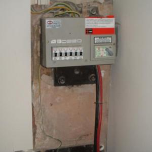

    Fuse Board and Appliances Buzzing
    I have tried pushing the case on the Main Switch and it doesnt appear to stop it. The only thing that makes it stop is turning off both ring mains. Or when it stops of its own accord. It seems to bear no relation to anything I do load wise. A bulb went upstairs last night and the unit tripped as...

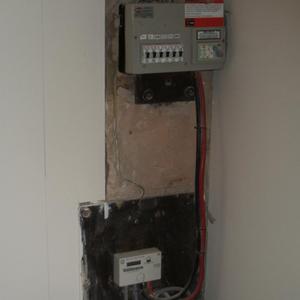

    Below are the pics of the Consumer Unit and the Socket where the kettle is plugged in.
    Will try and upload the photos later, when the damn weather is light enough to get a decent pic! Sounds like it is coming from the main switch where the wires from the meter connect in. Would this buzz feed down to other applicances like the kettle, TV, Microwave, PC that are plugged in as...
    It doesnt buzz when the main switch is off. It also doesnt buzz when the heating, downstairs lighting, upstairs lighting and cooker circuit are on. Only when either ring main is on, even with nothing plugged into the ring main at all. It hasnt done this before sunday, nothing has been...
    He checked for anything loose. Says it was all ok. He didnt check all sockets though but ran some tests on a gadget which they all passed. Is it worth me check each socket for any loose connections. Do you want to see the wires inside the consumer unit, it has a little brown cover on the...
  14. T
    Hi, I have recently encountered a problem a certain times of the day where appliances such as TV, Kettle and PCs have been buzzing, I have also noticed that the Consumer Unit is buzzing at the same time. This mainly happens in the morning when very little has been on. I have unplugged all...
