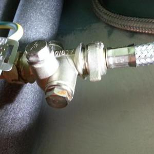

    Filling Loop. What is this?
    :whistle: 25 years later, I can finally fill up the system without having to run up and down the stairs like a lunatic!
  2. T
    Just for completeness, I finally got around to fiddling, and the valve pictured is a double check valve with a test port in the middle. The other two ports hold the springs. Therefore, have to tee in a pressure gauge rather than using one of the ports as I'd originally hoped.

  5. T
    I'll have a fiddle the next time I drain down the system!
  6. T
    Another atupid question... how does one use the port to test whether the valve is working?! :?:
  7. T
    Guys, Can anybody tell me whether this a check valve on the fill loop. It's getting on 25 years old but still works fine. What are the ports for? One is capped TEST, would that be pressure test and, therefore, could I install a pressure gauge there as the pressure gauge currently resides on top...
