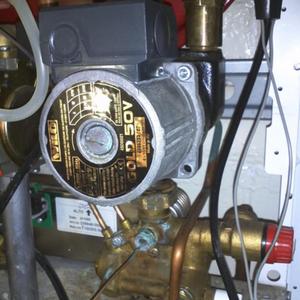

    Replacing Ariston A/23 MFFI combi Wilo Gold 50v help
    Managed to find what the replacement pump part number was and get hold of one. Is a Grundfos 15-60 pump and it has a 3 speed setting and the auto air vent built in. Setting 2 was equivalent to the old Wilo pump but with it on setting 3 all problems are sorted. Everything heats up quicker and...
    Thanks for the reply. Have had the pump out and everything is clean and clear. The pump is getting old now and as I say, we have added a lot of pipework (this is fitted in a commercial building, not a domestic home) so I don't think it's powerful enough any more. Replacing the boiler isn't an...
    Hi all. We have an Ariston Eurocombi A/23 MFFI with a Wilo Gold 50v pump. We have added a lot of pipework and several more radiators to the system and now the temperature difference across the inlet and outlet on the boiler is nearly 20C (and some of the rads at the end of the run struggle...
