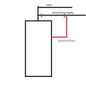

    Essex Flange to feed shower pump and the rest of the house
    Done a quick sketch of changes. If i leave the existing pipe in place it would allow air bubble to be drawn up to the pump, hence needing an essex flange, i have been told by the supplier that a suffolk flange is not suitable (that was going to be my original route to fix the problem.
    The pump i have decided on is a salamander ESP CPV it is switchable between positive and negative to allow me to decide on best operation. The tank is also a big one so am not too worried about water capacity. I am mainly worried about the essex flanges capability to supply pump and house from...
    Hi I will be installing a shower in the loft of a house. I the instructions it requires an essex flange. The problem i have is that i cannot supply the pump with an independent feed. If i fit an essex flange can i supply the whole houe plus the pump from the one feed blanking the outlet at...
